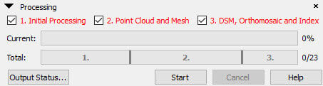

The Processing bar allows the processing of a project.
It contains 1 section:
It also contains 2 Progress bars:
and the buttons:
  • Output Status...Opens the Output Status pop-up.
  • Start: Starts the processing of the selected processing steps.
  • Cancel: Cancels processing.
PIX4Dmapper processing bar
Processing bar display.
Processing
The Processing section contains 3 subsections:
  • 1. Initial Processing: Automatically extracts keypoints from the images to compute the internal and external camera parameters using the software's advanced Automatic Aerial Triangulation (AAT) and Bundle Block Adjustment (BBA). A sparse 3D point cloud is computed and a low-resolution DSM and Orthomosaic are generated and displayed in the Quality Report. For more information about the files generated during the Initial ProcessingWhat are the output files after....

  • 2. Point Cloud and Mesh: Generates a dense 3D point cloud and a 3D textured mesh. For more information about the files generated during the Point Cloud and MeshWhat are the output files after....
Warning: When reprocessing this step, the existing outputs of step 2 are deleted and overwritten and outputs of step 3 (if previously completed) are deleted.
  • 3. DSM, Orthomosaic and Index: Generates the DSM, orthomosaic, reflectance map and index map. For more information about the files generated during the DSM, Orthomosaic and IndexWhat are the output files after....

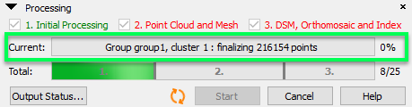

Current
It displays the processing status of each substep as a percentage.
PIX4Dmapper current tatus in processing bar
The Current bar within the processing bar.
Note: When the project is processing, information about the substep that is currently running is displayed in the Current bar.

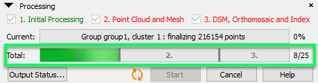

Total
It displays the processing status of all steps of processing that have been selected as the number of completed substeps.
PIX4Dmapper total status in processing bar
The Total bar within the processing bar.
Note: When the project is processing, the processing steps (1, 2, 3) that have been selected are displayed in the Total bar.
