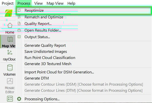

This PIX4Dmapper article clarifies when and how the process of reoptimizing the internal and external camera parameters should be used.
Access: On the Menu bar, click Process > Reoptimize (enabled once step 1. Initial Processing has been completed).
Reoptimize in PIX4Dmapper
