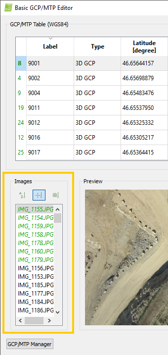

This section displays a list of all the project's images.
For each selected point on the GCP/MTP Table section, the Images section is shown with:
  • Green color: The images on which the point has been marked.
  • Black color: The images on which the point has not been marked.

There is one context menu for the Images section that can be accessed by right clicking on one image. The context menu gives access to the following action:
  • Remove Mark: Deletes the marked point that appears on this image.
