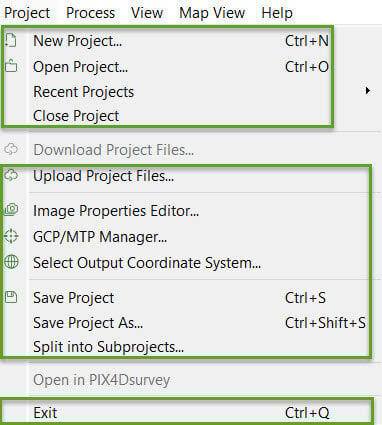

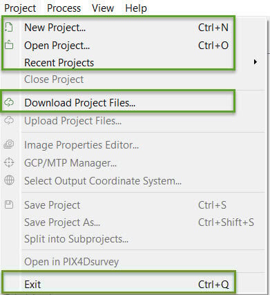

Depending on whether there is a project loaded/created, different options will be enabled or grayed out:
Available options before a project is loaded or created.
Available options once a project is loaded or created.

Download Project Files...
Allows to download and load a project previously uploaded to Pix4D Cloud. This option is enabled when the software is opened and disabled once a project is loaded or created.
For step by step instructions: How to download / open a previously uploaded project.

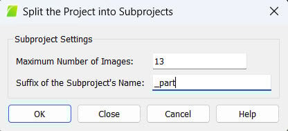

Split into Subprojects...
Allows to automatically split the project into subprojects by creating different .p4d files.
Each .p4d file contains the images for the created subproject.
The different subprojects overlap, therefore, some images will appear in more than one subproject.
Important: Only aerial projects with geolocated images can be split.
By clicking Split into Subprojects... the Split the Project into Subprojects pop-up will open:
It contains the following options:
  • Maximum Number of Images: Defines the area to be used to split the terrain into subprojects. When selecting for example 100, a subproject will cover the area from 100 images plus some area and images from neighboring subprojects so as to ensure there will be overlap between them.
  • Suffix of the Subproject's Name: Text to use as suffix for the subprojects. Each subproject will be named as projectname + Suffix + Number.
Important: All the Manual Tie Points, GCPs, Check Points and Objects created in the original project will be copied into all the generated subprojects.

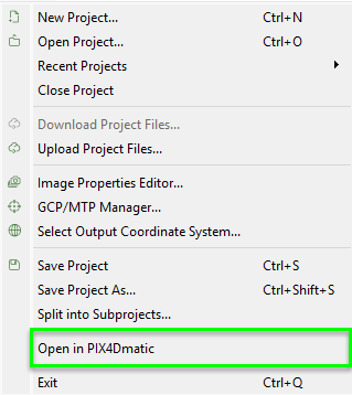

Open in PIX4Dmatic
From Mapper 4.10.1 the "Open in PIX4Dsurvey" option has been replaced by "Open in PIX4Dmatic"
openinmatic_mapper_
Note: This function is not available from PIX4Dmatic 2.3.0 onward due to a change in the installer. As a workaround, open PIX4Dmatic and import the .p4d file manually.

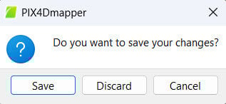

Exit
Closes the project and exits the software.
Important: If changes have been made and the project was not saved, the following pop-up appears:
Click Save to save the changes and exit, Discard to exit without saving, and Cancel to keep the software open.
