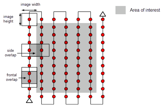

General case
The recommended overlap for most cases is at least 75% frontal overlap (with respect to the flight direction) and at least 60% side overlap (between flying tracks). It is recommended to take the images with a regular grid pattern (Figure 1). The camera should be maintained as much possible at a constant height over the terrain/object to ensure the desired GSD.

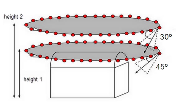

Reconstructing 3D buildings requires a specific image acquisition plan (Figure 2):
- Orient the pitch of your camera so that the majority of the image frame is filled with the object that you want to reconstruct and objects that you do not want to reconstruct comprise the minority of the image frame. There is no perfect camera pitch angle that can be applied to all missions.
- Fly a second and third time around the building increasing the flight height and decreasing the camera angle with each round.
- It is recommended to take one image every 5-10 degrees to ensure enough overlap, depending on the size of the object and its distance to it.
- The flight height should not be increased more than twice between the flights, as different heights lead to different spatial resolutions. For more information: Can PIX4Dmapper process Images taken at different Flight Heights?.
- PIX4Dmapper generates a high-quality point cloud for oblique images of buildings. However, no orthomosaic is generated, when the selected template is 3D Models: Processing Options Default Templates.
The images should have enough overlap in each dataset and between datasets. For such cases, it is strongly recommended to use GCPs or Manual Tie Points to adjust the different sets of images properly.

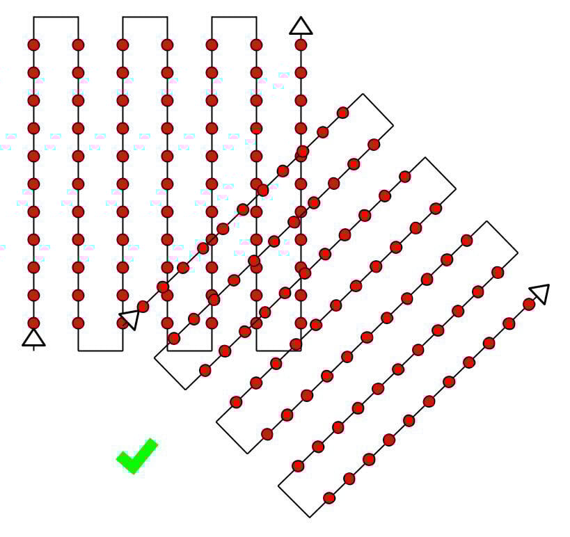

If a dual-track image acquisition plan is not possible, a single-track image acquisition plan can be used if (Figure 4):
- Overlap is high enough: At least 85% frontal overlap.
- Ground control points (GCPs) are defined along the flight line in a zigzag pattern.

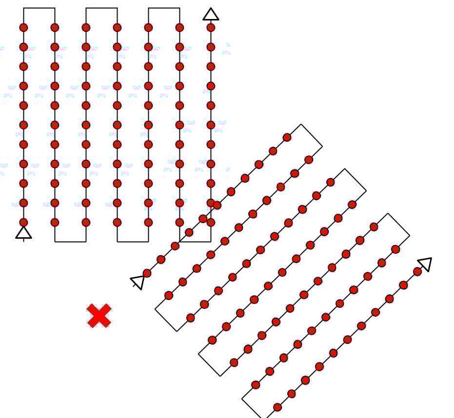

Multiple flights
PIX4Dmapper can process images taken from multiple flights. When designing the different image acquisition plans, make sure that:
- Each plan captures the images with enough overlap.
- There is enough overlap between 2 image acquisition plans (Figure 5).
- The different plans are taken as much as possible under the same conditions (sun direction, weather conditions, no new buildings, etc.).

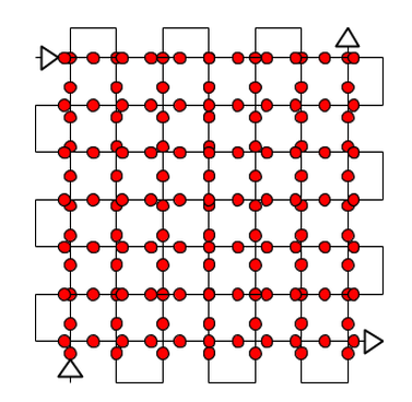

City reconstruction (visible facades)
The 3D reconstruction of urban areas requires a double grid image acquisition plan so that all the facades of the buildings (north, west, south, east) are visible on the images. The overlap should be the same as in the General Case.
For the facades to be visible, the images should be taken with an angle between 10o and 35o (0° - the camera is looking down). If much detail is needed, aerial and terrestrial images should be combined.

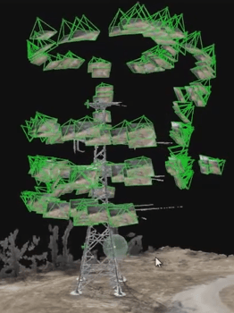

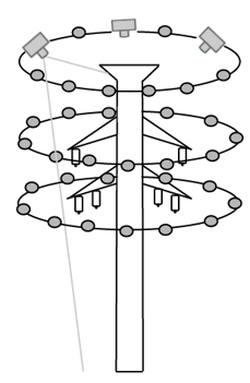

Large Vertical Objects reconstruction
The 3D reconstruction of objects that are tall and slender requires a specific image acquisition plan (Figure 8):
- Fly close to the structure.
- Turn several times around the structure at several heights.
- Images should be taken with high overlap: 90% of overlap between images taken at the same height and 60% of overlap between images taken at different heights.
- Everything in the image frame must be in focus, including objects in the background that are outside the project area.
- Having image geolocation is recommended.
Power Tower
Power Tower reconstructed in the rayCloud

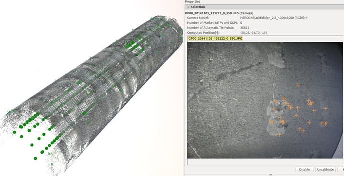

Tunnel reconstruction
PIX4Dmapper can reconstruct tunnels. The biggest challenge for tunnel reconstruction is the lighting conditions. If the lighting is good either with natural light (if the tunnel is not too long) or with artificial light, the reconstruction could be very good.
In case of very dark tunnels, a tripod is recommended.
- Use a fisheye lens camera.
- Take images in more than one line (avoid single-track shooting). If a multiple-track image acquisition plan is not possible, a single track could work. GCPs are highly recommended in this case.
Figure 9. Automatic Tie Points of a tunnel.
