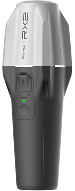

Mount the Pix4D-supported Emlid RTK rover to the device

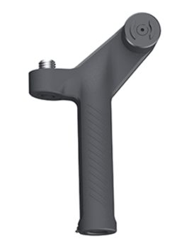

The PIX4D-supported Emlid is a GNSS RTK receiver that allows PIX4Dcatch to geolocate the images acquired by your mobile device with centimeter accuracy. The PIX4D-supported Emlid RTK rover can be coupled with mobile phones (iOS) using the SP connectors (cases or clamps) provided by SP Connect.
Note: The SP connectors can be obtained when purchasing the PIX4D-supported Emlid RTK rover. They can also be purchased directly from SP Connect and most electronic, bicycle, and motorcycle shops. Refer to the manufacturer's instructions for further details when mounting for the first time. If the mobile device does not have a custom case available (e.g. Android phones), the universal clamp can be used.

First, insert the phone into its compatible SP-connect case. Then, mount the case to the device by following the instructions provided with the SP-connect case.

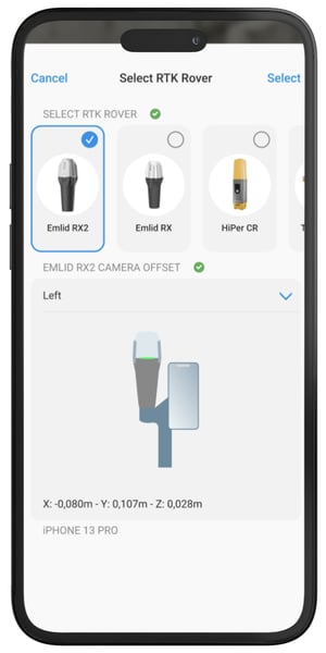

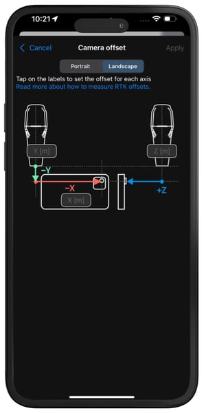

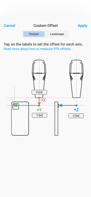

When initiating the connection to the PIX4D-supported RTK devices, the dialog RTK Device Settings opens. The section Camera Offset allows the user to set the X, Y, and Z offset values properly. The available options depend on the combination of the PIX4D-supported Emlid RTK device version, the mobile device and the device case. The following options are available: SPC+ and Custom.
The option SPC+ is only available if the combination of the PIX4D-supported Emlid RTK device version, the mobile device and the device case are known. The option Custom is always available and intended to be used by universal or specific cases. This option requires measuring the camera offsets manually and setting them in PIX4Dcatch. The camera offset value selection is saved for the next measurements and modifications are only needed if the setup changes.

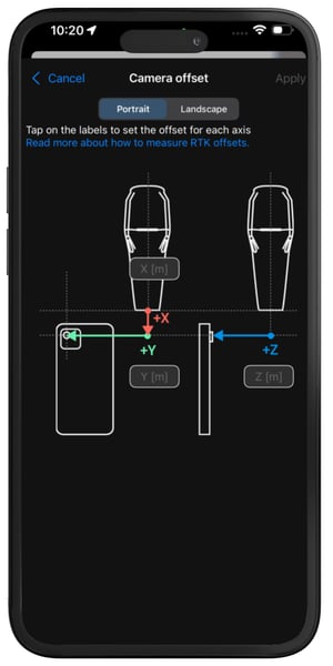

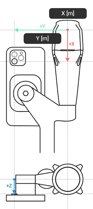

Place the device in landscape mode and the display to the front. Notate the orientation of the X, Y, and Z axes and how they relate to the point of origin on the antenna to measure from. The point of origin resides in the middle of the screw mount at the base of the antenna. It will also be necessary to determine which lens to measure from for devices with multiple camera lenses.
Tip: If unsure which camera lens to measure from, open PIX4Dcatch and place an object in front of each lens. The lens that becomes blocked is the correct one to measure from.
Measure the X and Y axis
To measure the X-axis offset, measure the X-axis on the vertical axis from the middle of the antenna to the point where it intersects the Y-axis. Then, measure the distance from the camera lens to the bottom of the mount.

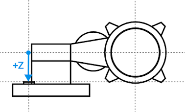

Measure the Z axis
Measure the depth from the center of the handle to the center of the lens for the Z axis offset.

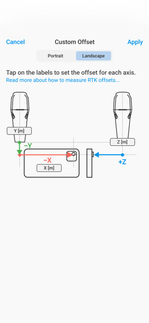

Enter the camera offset values
With the camera offsets properly measured and recorded, they can be included in the appropriate Camera Offset Values field. Depending on the device's geographical region, centimetres or inches will be the displayed measurement unit.
      portrait offset               landscape offset
The camera offset is now properly set in the Camera Offset Values X, Y, Z fields. Continue with the RTK Device Settings dialog to complete the PIX4D-supported Emlid RTK connection to the device.
