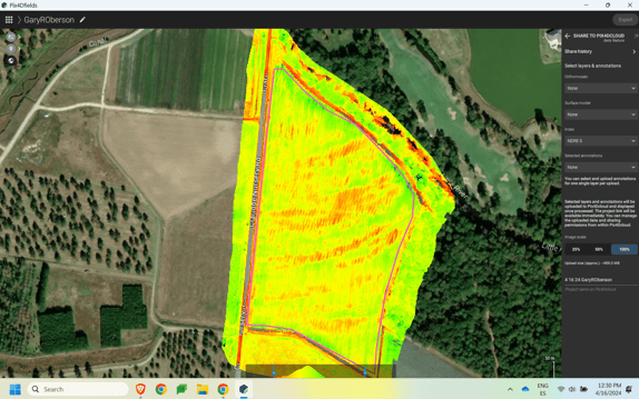

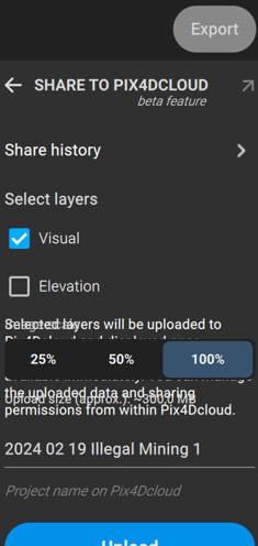

Let's take the example of sharing to PIX4Dcloud. You might find that the Upload button is missing, or the menu is misaligned, making it impossible to proceed with the action.

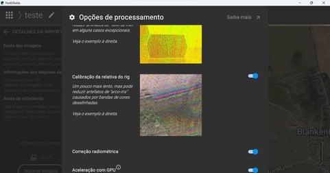

Similarly, during image processing, the Processing options appear unnaturally large.

These anomalies typically arise from display settings. When the scale is not appropriately adjusted, elements within the interface may behave unexpectedly. This can manifest as missing buttons, oversized menus, or improperly sized icons and fonts.
Reducing scale
Follow these steps to adjust the display settings:
  • Right-click on the desktop or type Display settings in the search bar.
  • Click Display settings.
  • Click Scale.
  • Reduce the Custom scaling.
If the problem persists, reduce it even more.

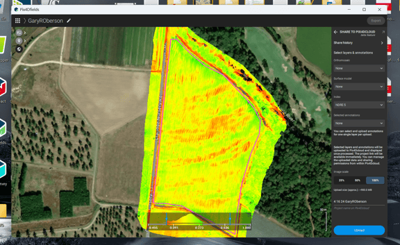

Reducing PIX4Dfields windows size
There are some cases that are resolved by simply reducing the window size.
For example, if PIX4Dfields is in "full screen", the Upload button is not visible.
The Upload button is visible when the size of the PIX4Dfields windows is reduced by double-clicking on the upper gray bar and adjusting the size.
