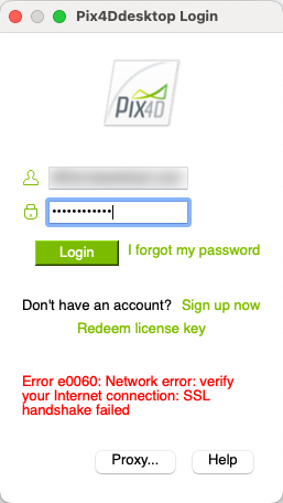

Error e0060: Network error: Validate your Internet connection: SSL handshake failed
Error e0062: Server Communication problem. Please try again later
PIX4D software compatible with MacOS
In February 2018, PIX4D halted development of the MacOS variant of PIX4Dmapper. Subsequently, this version transitioned to beta status and is no longer eligible for official technical support. The final iteration of PIX4Dmapper engineered for Mac was version 3.0.18, compatible with MacOS up to Sierra 10.12.
Modern updates to MacOS have rendered version 3.0.18 incompatible, as it relies on outdated connection protocols unsupported by contemporary MacOS versions. Consequently, users may encounter difficulties connecting to PIX4Dmapper's license servers, resulting in the expected Error e0060.
