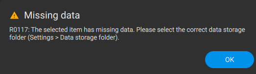

Error message
When trying to open the project, the following error appears:
Missing data
R0117: The selected item has missing data. Please select the correct data storage folder (Settings > Data storage folder).
