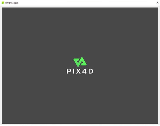

This article provides step-by-step instructions to solve the black or gray screen issue when opening PIX4Dmapper.
Cause
This black or gray loading screen appears when privacy settings are not configured. The specific configurations within the privacy settings are unimportant and must be filled in. Once the privacy settings have been established, the user can continue to use PIX4Dmapper.
