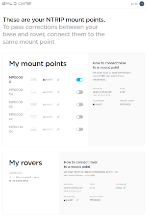

  1. Open a web browser and go to https://https://caster.emlid.com/app/mountpoints and sign in with your Emlid account.
  2. Manage mount points in the My mount points section. It is safe to use the default settings. Please save the name of the mountpoint and the corresponding password; these values must be used to set up the base station.
  3. My devices shows the credentials that have to be used by the RTK devices. Please save these values.

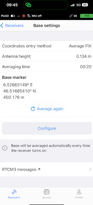

    3. Go to Base settings and define the base point coordinates and height offset. The following options are available. For more information please see the Emlid user documentation
      1. Manual entry - When you place the base over a known point
      2. Average SINGLE - The position of the base is calculated from a SINGLE solution over a pre-defined time period.
      3. Average FLOAT - The position of the base is calculated from a FLOAT solution over a pre-defined time period.
      4. Average FIX - The position of the base is calculated from a FIX solution over a pre-defined time period. In this case, the base station needs to be connected to another NTRIP service and acts as a device.
      5. RTCM3 messages - Select 10Hz
    4. Go to Base output and select the NTRIP option.
    5. Configure NTRIP access credentials. If Emlid's NTRIP caster is used, use the values from Emlid's NTRIP caster My mountpoints section; otherwise, use the default values to configure the credentials. IMAGE Definition of Emlid NTRIP caster credentials.
    6. Save settings
