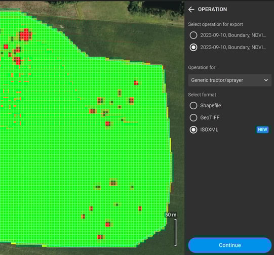

How to export ISOXML from PIX4Dfields?
First, a Targeted Operations map needs to be created. These maps can be created using a clean grid, using annotations (i.e., Magic tool detections), or creating a zonation based on an index layer. For more information: How to create a targeted spraying map.
Once the Operation map is ready:
    • Go to Export, at the top-right-hand side.
    • Click Operations.
    • Select Operation for, Generic Tractor/Sprayer.
