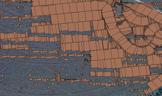

Example of an as-applied map (application map)with more than 8k polygons.
AssAppliedMapExample

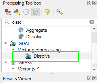

  1. Go to the top menu and click Processing > Toolbox (or click the “gear” icon to open the Processing Toolbox if it’s not already open).
  2. Find the Dissolve function.

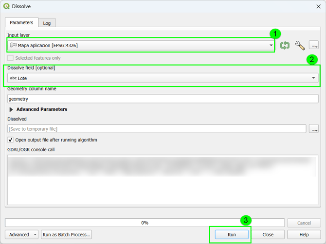

    image-png-Jan-15-2025-03-23-02-3779-PM
  3. Set the Input layer
  4. Select the Dissolve field if there's a column with the same name on all objects. Otherwise, leave it un-selected.
  5. Click Run
    dissolve_setting

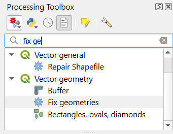

    1. If an invalid geometry error is present, run a Fix geometries before dissolving.

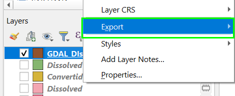

  6. Once the Dissolved is done, Righ-click on the dissolved layer.
  7. Click Export, and Save feature as.
    Export

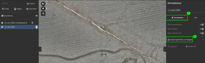

  8. Go to PIX4Dfields, Annotations, Import geometry.
    importAnot

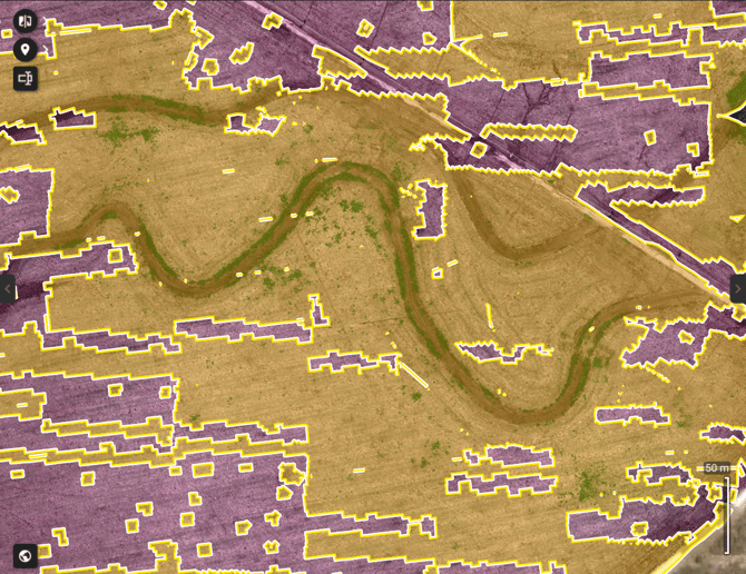

  9. Example of the dissolved As-applied map imported to PIX4Dfields as Annotations.
    ASsApplied_Imported
