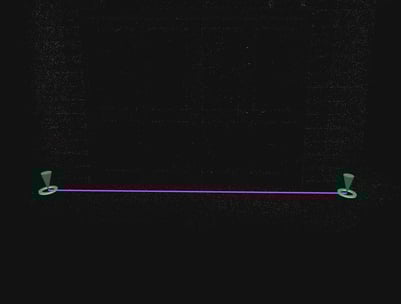

Scale constraints in the 3D viewer
Scale constraints are symbolized in the 3D viewer as a magenta line.

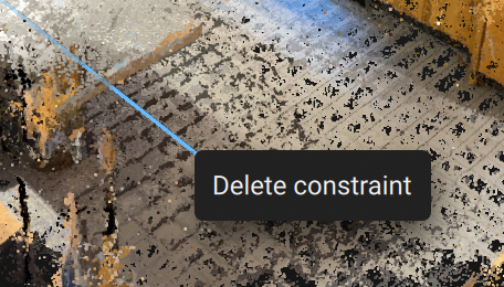

Deleting a Scale constraint
The Scale constraint can be deleted by right-clicking on the constraint while in the 3D viewer.

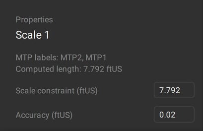

Properties panel
The Properties panel displays the length of the Scale constraint along with the accuracy of the line. When a new Scale constraint is created, the correct length must be entered in the Properties panel.

    3. Enter the length of the constraint in the Properties panel.
