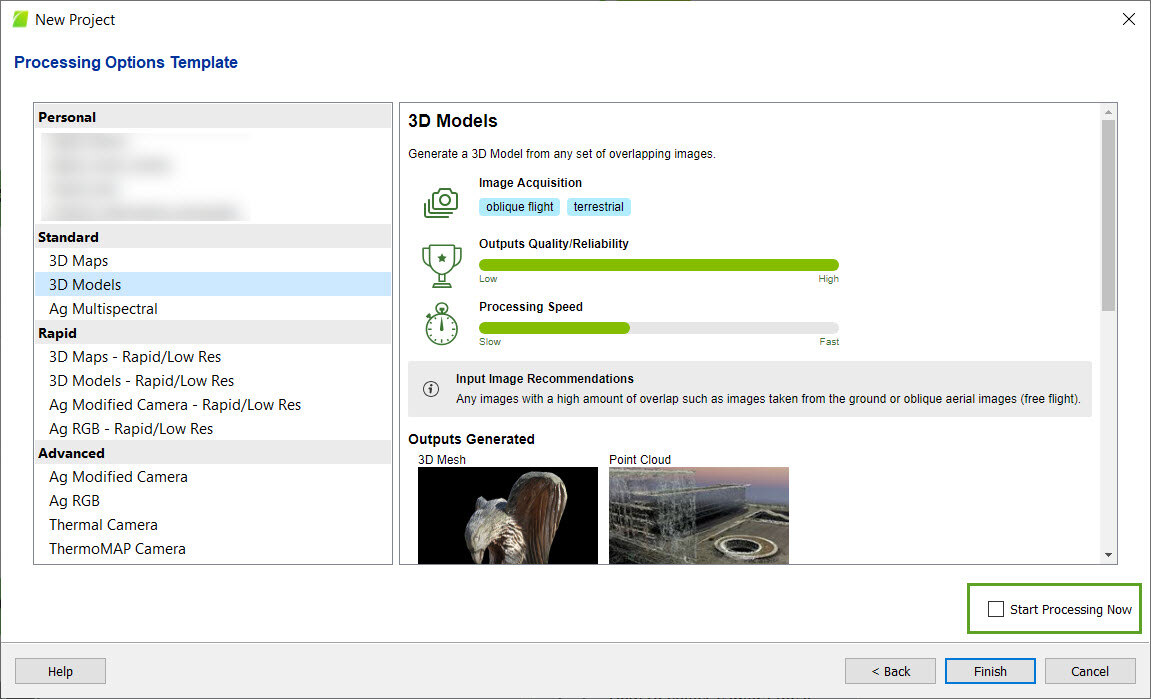

New project
To process step 1 only, proceed as follows:
  • When creating a new project:
    • Uncheck the Start Processing Now box at the end of the wizard before clicking Finish.
