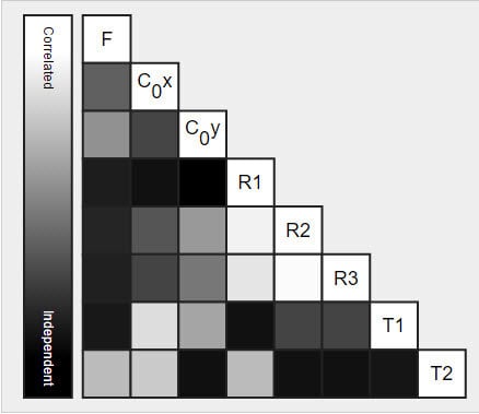

In the Quality Report the correlation values are represented by shades of grey. The darker the color, the smaller the correlation between the parameters.
