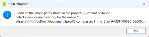

d. Some of the image paths cannot be found.
The images of the project are moved to another location.

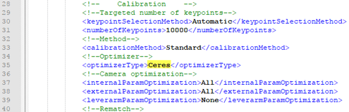

b. Invalid format.
Edit the .p4d file using a source code editor like Notepad++.
  1. Open the .p4d file using Notepad++.
  2. Go to line 35 and set the OptimizerType to Ceres.
  3. On the menu bar, click File > Save.

  • Leo Nguyen
    I'm not able to open a project that was processed on the web.  When it was complete and downloaded, I tried to open and first got a message that some of the image paths could not be found and to select a new directory.  I found that the images were actually missing from the downloaded folder, so I copied the images from the sd card into the folder, then selected that path.  But the box just keeps popping up again and again no matter how many times I select the folder.
    If I cancel the load and try again, the next error I get is Error e0400g, non expected parsing error.  If I shut down the program and restart it, it goes back to the other issue of not finding the path.
    I'm unable to resolve this issue.
