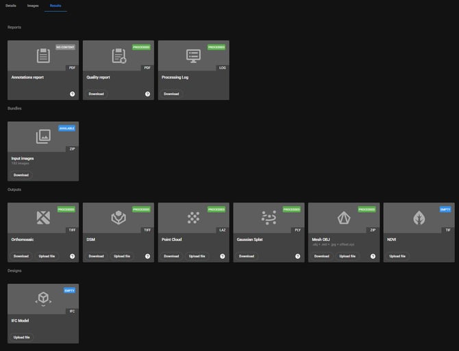

After processing on PIX4Dcloud, the results can be downloaded singularly or as project folders.
To download results:
- Open an already created dataset.
- Go to Files & Reports > Results to display the list of downloadable items.
- Click Download on the desired output.
- If asked, specify the format to export the output locally.
- The requested output starts downloading.
