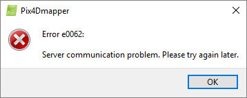

Error e0062: Server communication problem. Please try again later.
or crash when trying to launch PIX4Dmapper that is already logged in.
Description
Starting Sunday, February 5 of 2017, the error message e0062 appears when trying to log in/out or the software crashes upon launch when using the following versions:
  • 2.1.61 and older
  • 2.2.25 and older
  • 3.0.13 and older
  • 3.1.13 and older
To determine which version of PIX4Dmapper you are using: Menu Help.
Cause
The issue is related to the certificate of communicating with the server which expired, Sunday, February 5 of 2017.

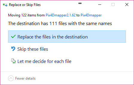

  4. Click Replace the files in the destination, if the following pop-up appears:

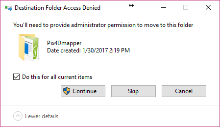

  5. Click Continue and select Do this for all current items in the following pop-up:
