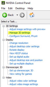

    • In the Control Panel window, select Hardware and Sound and click NVIDIA Control Panel.
    • In the All Control Panel Items window, click NVIDIA Control Panel.
3. In the NVIDIA Control Panel window, in the section 3D Settings, click Manage 3D settings.

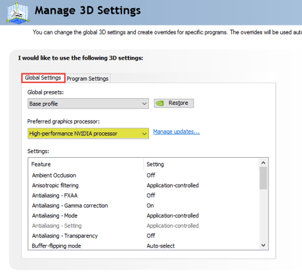

4. In the tab Global Settings, under Preferred graphics processor select High-performance NVIDIA processor from the drop-down list.

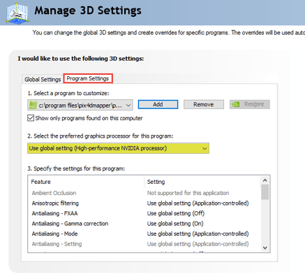

5. In the tab Program Settings, select the program to customize. Eventually, click Add to browse for it.
6. Under Select the preferred graphics processor for this program, select Use global setting (High-performance NVIDIA processor) from the drop-down list.
