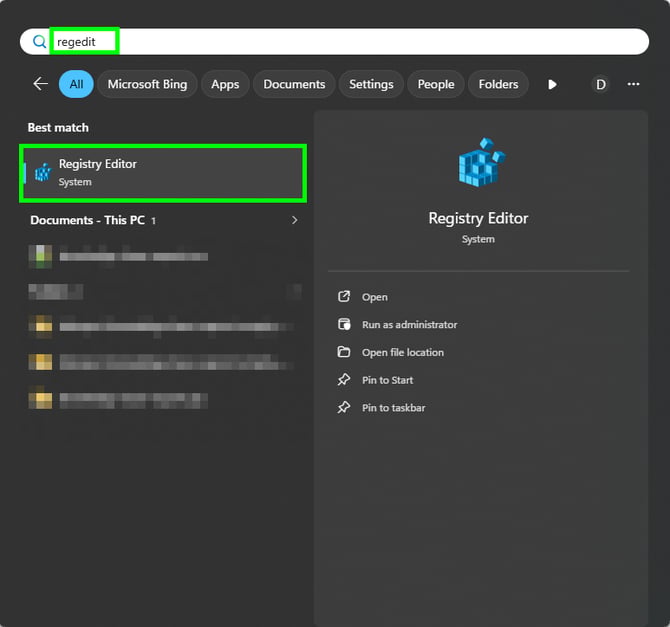

  6. In the Windows Search type RegEdit and open the Registry Editor.
    Regedit search

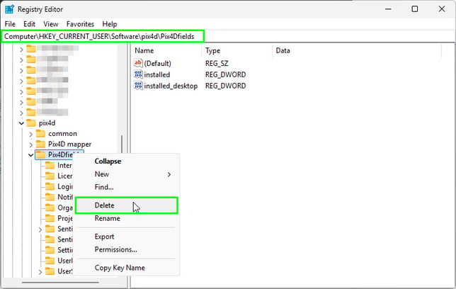

  7. Locate the folder stored in the path: HKEY_CURRENT_USER\Software\pix4d\pix4dfields and ensure this folder no longer exists. If it exists, DELETE this PIX4Dfields folder.
    PIX4Dfields_Regedit_Delete-1
