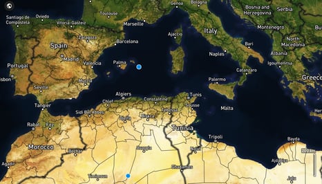

Problem with the EXIF tag of the images
Sometimes the EXIF tags of the images are not correct, and this causes PIX4Dreact to fail when processing. On some occasions, images have incomplete coordinates in the EXIF of the images. If images are located in a different place on earth, this is typically the problem. The images with faulty GPS coordinates should not be selected for processing.
