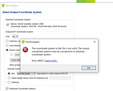

Error description: e9027 The coordinate system in the file is not valid. The output coordinate system must be a projection or arbitrary coordinate system. This article highlights a few of the most common solutions to aid the invalid coordinate system issue.
Make sure the project file is in a projected or arbitrary coordinate system
