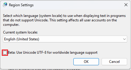

Option 1: Enable Beta: Use Unicode UTF-8 Support
Windows UTF-8 support can also be enabled to handle non-ASCII characters in file paths across system applications:
  1. Open Region Settings in Windows.
  2. Go to the Administrative tab.
  3. Click Change system locale...
  4. Check the box for Beta: Use Unicode UTF-8 for worldwide language support.
    region_settings_2.10
  5. Restart the computer.
