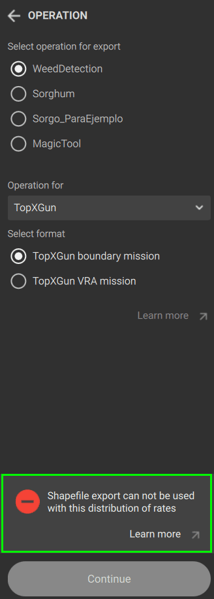

This article explains the limitations when exporting a shapefile as a boundary mission for the TopXGun drones. The error below is shown "Shapefile export can not be used with this distribution of rates" .
CannotExportMessage_BoundaryMission
