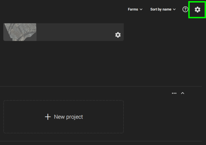

In order to log out from PIX4Dreact
- Click Settings icon.

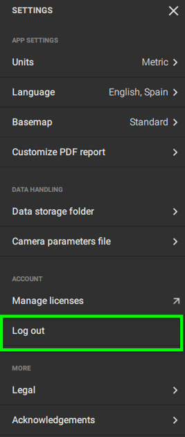

- Click Log Out.
- The free license can be used on any other device by logging in with the Pix4D account.
