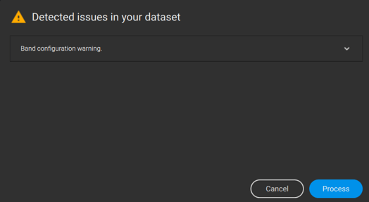

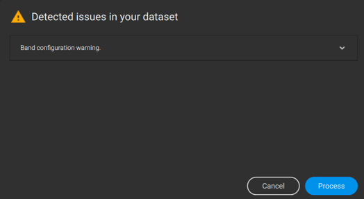

 After importing the images and clicking Start process, the following errors may appear:
  • "Detected issues with your dataset. Some files in your dataset could not be processed."
  • "Detected issues with your dataset. Band configuration warning."
    Detected Issues in PIX4Dfields
Description
  • Some multispectral captures may have missing bands. Review the number of affected captures; processing may still be feasible.
  • Some captures may contain incorrect EXIF metadata, which has been observed with the Mavic 3 Multispectral.
Solution
  • If less than 5% of captures are impacted, the project might process well.
    Click Process and analyse the results.
  • If the orthomosaic has artifacts or can't be processed, please make sure you are running the latest PIX4Dfields version and drone firmware.
    • If the problem persists, please reach out to support. After engaging with the Pixie chatbot, simply select the option to create a support ticket. https://www.pix4d.com/support/.
