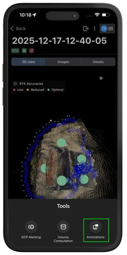

  2. Go to the annotation tool
    Tap on “Tools” and then select “Annotation” from the menu.
    tool box

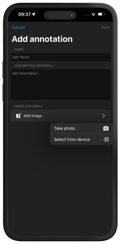

  3. Fill in the annotation details
    • Title: Give your annotation a clear, concise title.
    • Description: Add relevant notes, observations, or contextual details.
    • Photo: Either take a new photo with your device or attach one from your gallery.
    add annotation-1edit annotation

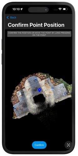

  4. Confirm the point position
    Using the mark to point the position.
    confirm point position

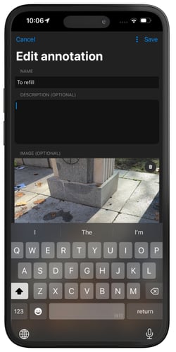

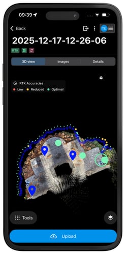

Edit Annotations
  1. Select manually the blue mark that contains the annotation to be edited.
    project view

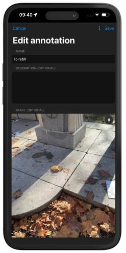

  2. Click the detail to be edited.
    edit annotation
  3. The picture can be deleted and upload a new one again.
  4.  Once is ready the annotation, save it.
