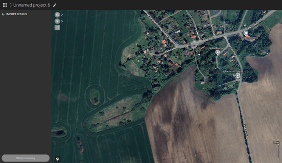

After importing the images, nothing happens, and it does not start processing.
The Start processing button is greyed out, it is impossible to start processing.

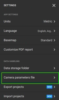

- On the dashboard, go to SETTINGS on the top-right and click Camera parameters file.
- Click Remove.

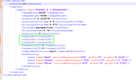

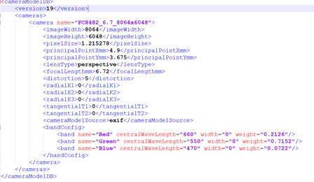

- Ensure the provided XML has the correct format:
- Ensure there are no empty tags:
- Ensure there are no incomplete tags like <rigs/> at the beginning or <mappings/> at the end.
